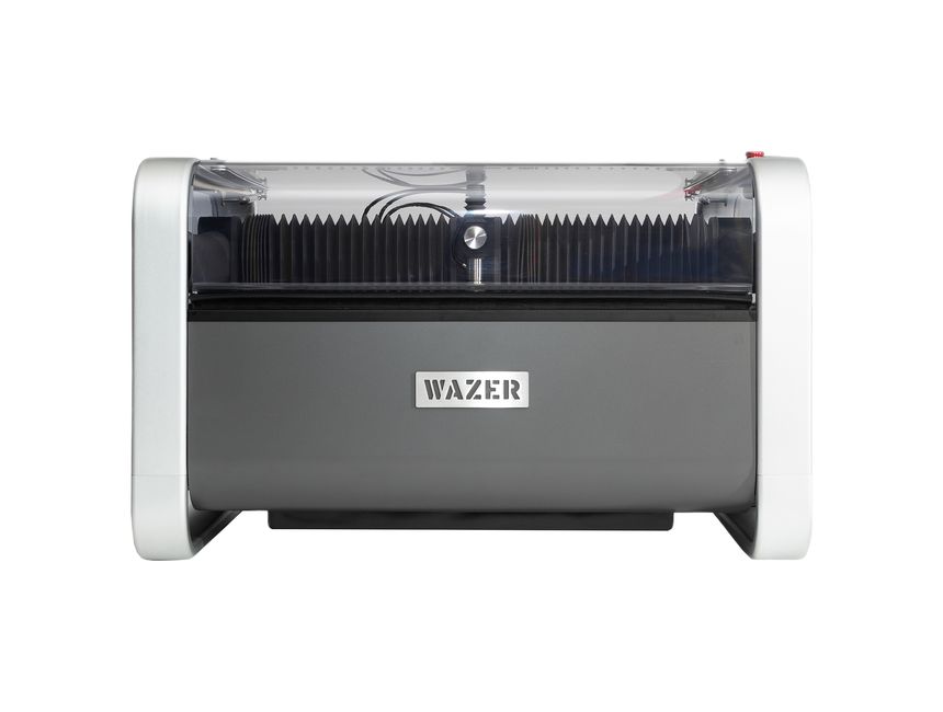

This being Garage Journal, the correct answer is, if you want clean cuts, buy or fab a waterjet saw.
Here's a nice one, very reasonably priced at $9,999:
