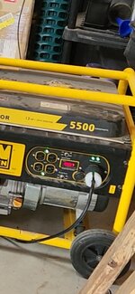

I bought a used like new Atlas 9000 two post Car lift I am installing in my garage. The lift requires 220 wiring and I don't have enough voltage running to the garage to hook up the lift to 220. As a result I have decided to try running it off my portable generator. It looks as though my generator has an outlet that supports 240V/120V. See photos. My question to the group is will this work, and has anyone ever tried this. The pictures attached are of the lift motor plate and the generator plug outlet.

mm08822
Jan 13, 2012
6,230
It should be ok. I'm struggling with the nameplate amperage......seems very high. Even if correct, nothing says the motor will draw full load amps.

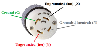

You will need a 3 wire cable to make the connection. Ground, X and Y. Neutral is not used on your lift, so it can be left unconnected. This photo represents the receptacle on your generator. Purchase a matching L14-30P plug. 12 gauge cord will work. I can't say if the generator will handle the inrush (startup current of the motor.) I expect that will be hotly debated in this thread.
YMMV

Great Thanks!!

I don't think it will work, at least not for long. The generator is under sized especially for when the hoist has a load. Generators are an annoying way to run electric motors due to having to allow for startup current.
I've tested a 3hp compressor on a generator the same size and it just managed to start it and that was with the compressor unloaded.

I want to say thanks to the Garage members for helping me get my lift up and powered with my 13hp generator. Dave*99 for telling me exactly what plug to buy and how to wire it. Worked perfectly. The attached video shows the lift lifting my jeep plugged into my Generator. The generator revs up a bit when the jeep leaves the floor, but does the job pretty easily.
