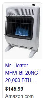

These are what I use. I have a 20k and a 30k unit. They're used as "emergency" backup heat for the house (in the event of a long power failure) and I use them in the shop. They're easily hung on the wall. 20-30k will heat a lot of space... These "just work" have a thermostat, oxygen depletion sensor, etc. They also come with "feet".
They have them in a "radient heat" version:
They also have a "blower" accessory, which I've never used:
