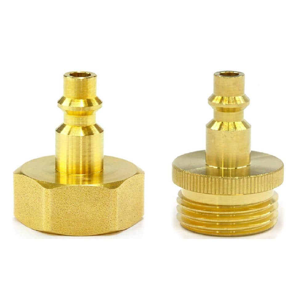

We blow out the water lines at our cabin everytime we leave int eh winter. A male airline fitting fits inside 1/2 pex nicely. A couple valves to both hot and cold, isolate the line from the pump, and set air compressor for 40 psi. Blown out in 15 minutes. Drain HW heater and RV antifreeze in the toilet. Been doing this for 15yrs no issue.

I apologize that I've not replied to the thread I've started. Got a little busy. The question was, would a sump be better than a transfer pump? I live in ND, I take no chances with frozen pipes. Rv antifreeze has been used in this home for 18 years and counting. After seeing nothing but antifreeze coming out of the faucets, it all gets blown out with air. Thx
