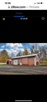

Hello , looking to purchase a piece of property and the pole barn is approximately 40 years old… you can see a lot of standing water/stains on the outside of the building. Obviously no gutters. My concern is if the posts are all rotted? What are your thoughts? What else should I look for? Thanks

I would look at the posts
They may have protectors or a coating, they might be mushy. No one here can tell

the water stains on the lower portion are nothing to be concerned with. as above poster says, look at the posts . after 40 yrs I suspect there will be some rot , how much is the question.

Thanks unfortunately all OSB covered. I can’t tell… I’m sure they aren’t coated

40 years ago they could have been creosote. Can you see any of the posts to find a grade stamp? What is the soil like around the building? Is the natural drainage away from the building?

How old is the OSB? What condition is it in?
If I was concerned, such as if there were signs of moisture inside around the post locations, I would;
Try to determine which post would have the most damage and remove the interior covering to access the base of the post where it enters the ground. Then a visual inspection making note of what kind of treatment and installation then probing the post where it enters the ground with a screw driver to see how much if any is rotten

You should be able to see the posts from the outside just below the siding. You may have to lay on the ground to see them but should be able to probe them with a screwdriver to tell if they are soft. They usually rot right at ground level.

Dig around the posts from the outside and see if any posts show likely rot, probe them with a screwdriver. Should only have to dig down 6" to find enough post to probe. Rot is more likely where the wood has been exposed to moisture and air. Below grade should be solid, at grade may show rot if any exists.

A sharp pick or knife to stick into suspect areas. If rotten, the pick will slide in easy and deep until it hits good wood, if ever.
Very little penetration indicates good wood.
