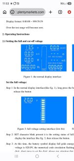

Thanks @kbeefy , @Perrorojo ..^^^^ all replies appreciated. Meter with a shunt ordered earlier, shows up tomorrow. What I'm not grasping is testing the battery on the bench, without the trolling motor. These meters/shunts on the negative side have to be under load to display, correct? IOW,,,how to test the battery state without the trolling motor.

The shunt is on the negative lead, but there is a small wire to the positive terminal to power the meter. You do need to get the battery all the way full to calibrate the meter to 100% SOC. Given the choice these days, I would buy a battery with a State of Charge meter built into the battery itself. Nothing else to buy and no issue if you move the battery between applications.
Gotcha, thanks. Yea, this was a spur of the moment purchase without much research on a cold snowy day dreaming of being on the water :LOL: Next unit will have the bluetooth and meter built in. This one was $129 on March 4...today listing for $174 :eek:
You'll most likely need to program the shunt to the battery. It will ask what the "full voltage" is and what the "amp hour capacity" is. You should have to pick "tail current" if it's a good shunt. Lithium batteries don't follow Peukert's theory so they have a setting for "discharge Floor". The battery probably has all the charger and shunt settings listed online. You can hook the shunt up without charging it. Set up the parameters and turn on the charger. When the battery reaches full the shunt should flip to 100% charge. That's the way Victron and most shunts operate.

Keep in mind this battery is just for a couple small boats cruising down the river and a couple farm ponds :LOL: Not near the league of the Victron equipment. Not sure what the options will be with this $20 unit I ordered.
Screenshot 2026-06-10 at 09-01-22 CGELE DC Multifunction Battery Monitor Meter with Shunt 0-20...png
That should work fine. It has the ability to program.
