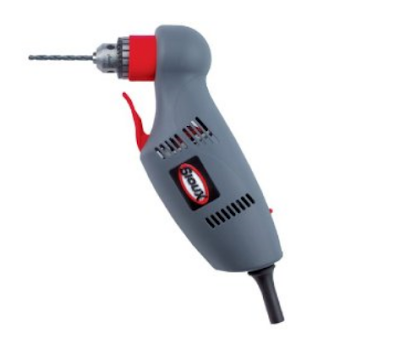

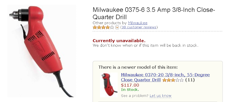

One option for drilling through joists is the Milwaukee 0375-6 3.5 Amp 3/8-Inch Close-Quarter Drill, which drill unfortunately has been dumbed down by Milwaukee into something only barely resembling its original incarnation. (I picked my 0375-6 up off eBay after I read the complimentary reviews on Amazon and saw that it had been discontinued.)
The Sioux 8000ES looks to be the same bird in different feathers, and I see Sioux selling both 3/8" and 1/2" versions:
http://www.coastaltool.com/a/ab/siou/si8000es.htm
www.siouxtools.com/kSuite/cmsLite/content/file/SiouxLit/Drills/8000ES_Drill_Brochure.pdf
Also:
http://www.siouxtools.com/portfolio_drills_zelectric.php
Sure it's goofy looking, but "form over function" often works that way...
