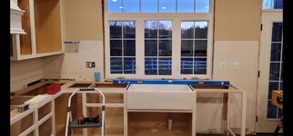

andyvh1959
Feb 15, 2020
2,598
Green Bay WI
When I modified my 1973 cabinet to install the farmhouse apron sink this year I added 2x4 bracing on each side, doubled up to get 3" of support. Then I added a center stile onto the framing I moved down to support the front of the sink, which I set up after countertop was installed over the sink. Set it all up 1/4"below the flush height of the cabinet so I could shim as needed, then framed in the opening under the front of the sink.
