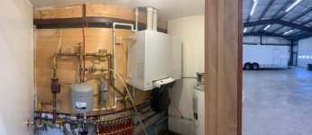

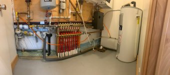

We are looking at purchasing a new home, it consists on a 2800sqft shop with 1000sqft attached residential. The entire slab is heated with radiant floor heating. I have zero knowledge with it and was wondering if anyone with more experience could take a look at some photos and tell me if it appears to be done properly. We do plan to have a home inspection done, but from past experience they generally just check to make sure everything is in working order.

Damnnnnnnn. That’s a serious system. Two manifolds? Lots of zones
fitter30
Jun 23, 2019
3,035
Peace Valley,mo
Everything looks good. Piping is correct zones piped reverse return first in last out. Thermometers in and out of the loops ( see how close they are to each other with system off). Didn't see a pressure gage should read around 10 lbs. Also want to sample the water see if there is glycol in system and the condition of it. Radiate systems run 5-10* above room temps max 85*. Cold system startup might take 3-4 hours before you start to feel it. Best heat ever.
