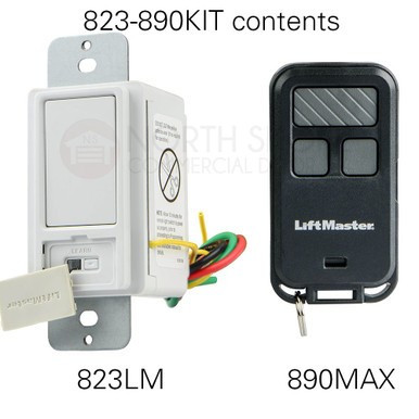

rawen2
Feb 26, 2021
173
High Desert of CO
Here is another one that has been discontinued but I found one on eBay. I thinks it's capable of what you want. It's the Liftmaster MyQ 823LM.
Looks like the one on eBay does not come with the remote so I'm not sure how you'd program it to the button on your car's visor.
Link to description:
eBay link:
Link to owner's manual:

Liftmaster 823LM (wired wall switch that can be controlled from GDO remote) is what you would have wanted, but it is discontinued. They pop up on eBay. The Liftmaster 825LM (supports both remote and myQ) is still available and would have to be cobbled together to control a light fixture. 825LM: https://www.liftmaster.com/825lm-wireless-light-control/p/G825LM
I had an 825LM that came free with my Liftmaster garage door opener years ago, but it sadly died after about 5 years. It had an option to use one of the remote buttons, but I only used it paired to the opener light. When it worked, it was great to turn on another light in the garage.
Doesn't help the OP here, but my replacement for the 825LM was to use MyQ to tell IFTTT to then tell my Hubitat hub to turn on some lights in the garage.
eBay link:
This seems to be exactly what I would like to accomplish, and at this price it is an easy option to try. I did purchase this, from the link you provided, thank you very much for the help with this.
You're welcome. Hope it works the way you want. And I'm happy I could help someone because this forum and others have helped me many times.
