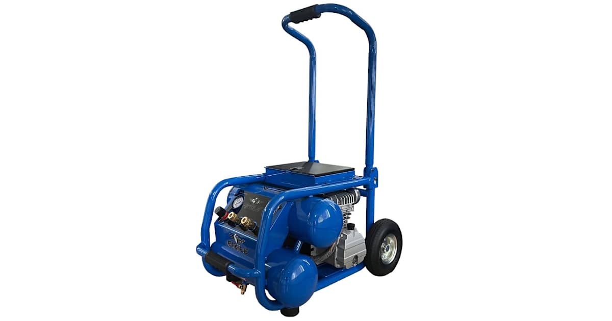

My rigid tri stack compressor failed to generate more than 70 psi recently. I tore it down and found the reed valve is broke. Replacement Parts aren't available and the piston seal and head gaskets need replaced, again parts aren't available(although I could find solutions for the gaskets). I have an old 30 gallon Westinghouse aircraft compressor that runs great (and slow speed) for larger work.
I would like suggestions for replacement of my rigid. I use it with coil framing nailers, air hammers, and various other tools. Noise is no so much of an issue because I still have the rigid 4 gallon tank with regulator that can be staged for larger volume capacity and to get the noisy compressor outside (or further away). I move this around some for various jobs, so reasonable weigh is a requirement. I don't care much for wheeled air compressor that can tip over easily. My primary concern is price, performance, and replacement parts available today (so I can stock up and net be in this situation in the future).
My primary considerations have been pancake compressors, which most seem comparable in design, with different pressure ratings that impact scfm rating at 90psi. Most of my work is not pressing, so I can generally pause between work.
I have been leaning towards Hart, Metabo HTP Tank, or Kobalt pancake compressors. Quiet compressors may be of interest, but I don't know about rebuild options especially with the dual piston designs that most at this scfm ratings have. My old Rigid had 4.9 scfm at 90, but I think I can live with a little less now
Thank you for any input that you provide

California Air Tools make "contractor grade" (?) quiet air compressors. Get a 1 HP model. No pancake, but small tanks (1, 2 or 4 gallon). They use a different style compressor head.
Only 2.2 CFM @ 90 psi but it will run a single nailer. Air hammer or impact, you might have to wait. Forget grinders, cut off wheels, sanders or sand blaster.
Parts ARE AVAILABLE.

CAT also makes 2hp models that make 5ish cfm.

Oil free with spare parts and industrial-level support basically mean CAT. Very few compressors of that kind offer full support.
Otherwise you’re looking at an industrial oil lubed and $$$.

Thank you for all of your input. I ended up ordering a CAT knock off(Fornax) from Amazon for $103.99. It claims to be a 1.2 hp 2.1 scfm at 90, max 125psi. This will be significantly less capacity than my old rigid, but the trade off in portability I believe outweighs the capacity (or should I say underweighs). I still have the bottom part of my tristack which allows me to have a 4 gallon regulated surge tank between my compressor and tool, helping some in capacity. Part of my decision is also on the storage footprint as my garage is full already and a larger wheeled compressor will take up valuable room. I have plenty of capacity with my old v Westinghouse air brake compressor on a 30 gallon tank around the house, which is a workhorse when the motor is functional (I have a 2 hp on it and am waiting for delivery of replacement capacitors for a harbor freight motor I installed about 6 years ago). I may upgrade this to a 3Hp eventually and adjust pulley size to increase capacity slightly. Now it is roughly 12 scfm at 90, if I remember my calculations correctly.
I know I am risking reliability and parts availability, with this compressor, but at the price I am willing to take that risk. I will update this thread after some use experience with my needs Fornax CAT knock off.

The Fornax CAT knockoff that I purchased is pretty much meeting my expectations. There is a cage around the compressor that would help protect the compressor against damage like the compressor above suffered. The capacity is sufficient for my work, but lacks (as expected) volume for running air hog tools like my cheap harbor freight die grinder. It runs my framing nailer like a champ. I do my compressor setup with the 2 gallon fornax hooked to my 4 gallon ridgid tristack regulated split tank and did upgrade the connecting hose to high flow fittings. The fornax fittings were compatible with the high flow male fittings that I purchased at Walmart. I made the change to highflow due to whistling at the Inlet fitting on the ridgid tank Inlet connection. The Fornax did have some slight shipping damage, specifically the compressor mounts were bent putting tension on the flex hose to the tank check valve which is not a big deal to me. Maybe sometime I will bend it back someday.

What else is out there in a similar form factor with oil lube pump and reasonably quiet?
The MAC 5200 has the airflow of a 25-30 gallon 120V compressor on a much smaller, more compact setup. It looks to be a great second compressor option.
But what else is there that's 5.5-6 SCFM at 90psi on 120V, oil-lubed and reasonably quiet? I mean, it doesn't have to be CAT quiet, but it just can't be 1990s Craftsman oil free loud.
Monologuing a little, it looks like this Eagle is nearly a dead copy of the Makita. The pump cover and oil drain looks identical.
Has the same specs, too.

AFAIK Rolair is about the only other compressor in a smaller footprint putting out good cfm with a rep for durability
