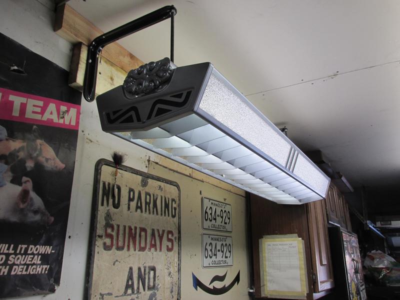

post up I picture if you can....... old lighting is cool. I keep an eye out on craigslist for something to pop up, there are tough to find
I did this one a few years back. it is an Day Brite made in the late 40's -50's
I converted to t8 electronic ballast. while the purest would shame me, I didn't want to deal with starters and old t12's. but still keep it a fluorescent.

I certainly hope that you have had your modifications performed by a union trained and certified electrician and then UL inspected and stickered. Otherwise the safety joes that love to scream "call a lawyer","that's not code" and where's my mommy" that live on this site
definitely will have a conniption and throw a hissy fit...
Screw them guys, it looks cool and I like it. :beer:
