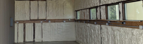

I've done it both ways. In the most recent garage "addition" (we closed in a wing of our shop) - I just put 8" of 3/4 ply across the horizontal purlins and then used gray PVC conduit (surface mount) and did it that way. Some if it I didn't even "glue in" just in case I want to make a change in the future. Here's the rough idea:
