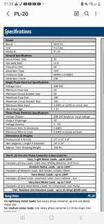

Should be a 20hp idler. The data plate would help.
Something between a 50 and 100a circuit
Typical 20hp rpc:

Q: jar944 - what is 20HP idler? That is just some parameter of the motor, correct? Not any reference to some 2nd start-motor (which this does not have).
The motor that makes up the rpc is typically referred to as the idler. In your case it should be 20hp.
