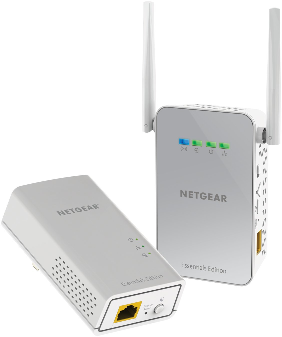

A tip for anybody looking to run ethernet to their shop:
I ended up going with the netgear powerline adapters. They run an encrypted ethernet signal through the power wire.
My shop is 150' away from the house. Power is 100A using 01/01/01/1 urd brurial cable. It gets a full signal, even with the compressor noise.
This one acts also as a wireless router with wifi, and it has an ethernet out.
It's a max 1.0gbps. I have mine direct wired to a separate wireless router.
In hindsight I should have gone with the 2.0gbps wired model instead.
https://www.amazon.com/NETGEAR-PowerLINE-1000-802-11ac-Gigabit/dp/B01929V7ZG/ref=sr_1_3?ie=UTF8&qid=1538463216&sr=8-3&keywords=netgear+powerline+1000

Anyone know if that Net Gear box will work thru a meter connection?
I have a 400 amp service, 200 amp to the house and 200 to the shop split with separate breakers...2 hots and a neutral each way from a common bus. Seems like it should work...eh?
