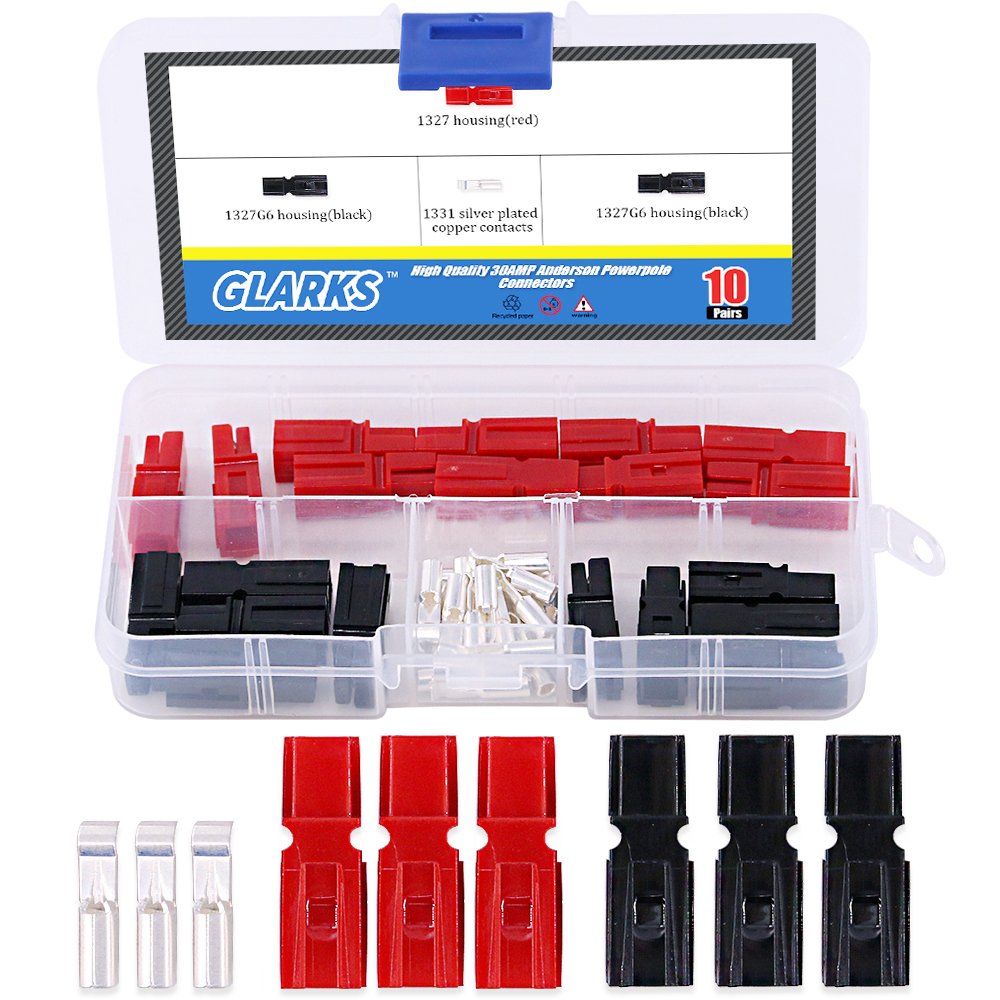

Anderson PowerPole connector are a good 12VDC solution. They come in multiple sizes and individual pieces (crimp contacts and plastic shells). Ham radio operators have been using them for years because they a reliable and easy to use. Also, in the event that one pair gets assembled "backwards", you can easily disassemble it and reverse the colored outer shells.
With a kit like this, you can "roll your" anytime and not worry if you are on the battery side or the load side !

+1 on the anderson power pole connections... I found the "30A" connectors tend to be a more common size. But, you need to be sure the crimp is a good mechanical connection.
I have crimped a "30A" connector on a 16awg zip cord and had the connector pull off. I had to double over the stripped portion of the stranded 16awg to get a good mechanical crimp with the 30A sizing.
I am okay with the "bullet" styles as long as I am CLEAR on which size is + / -
The power pole connectors are red/black to make it really easy to identify and avoid shorts/ blowing up or melting your gear.
