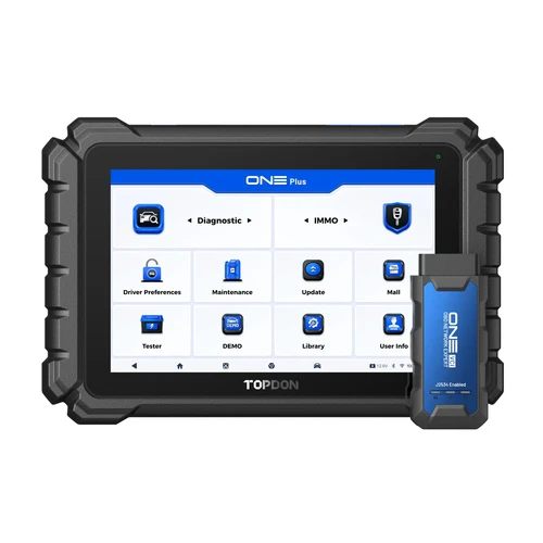

When looking at cheap bidirectional scanners be careful. Unlike my old snap on scanner many of them stop allowing you to use advanced features when the subscription runs out.
I recently purchased a top don X800 BT and I am very happy with it. The best part is it has lifetime updates for free.
It’s basically a small android tablet with a wireless dongle. It does most everything I need it to, it’s bidirectional and will do a lot of special services including CVT relearn (great for Subarus) and battery resets etc. We have VW’s, Subaru, Kia, and GM in the family fleet.
Good luck with your hunt!
