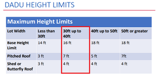

I mocked up some front and side views with what I think are reasonable assumptions on joist height and wall thickness etc..
I'm only 5.8' but using a 6' scale person and my Rav4 for context.
@TX4runner as you mentioned I can eat ~6-12" from the garage to make the upstairs higher if needed (closers to a 7' kick wall)
Note: side view is only of the thinner side section and so not including the front of the garage
Seattle Rules (LINK) (might be out of date but good enough for now), I can probably use an average for ground height given the difference between the front and back but it looks like this will be ~23' from the lowest point, which works (just) anyway

The picture visual helps. It doesn't look as bad as my vision of getting to the top of the stairs at the back wall and being very close to the ceiling at 5'11.
Part of the question for me was which goal has higher priority, tall garage projects or hangout time upstairs. I'm coming from a garage with about 8 foot walls before the rafters. I knew I couldn't get a lift in there so I got QuickJacks and lift cars up about 2 ft. I just moved, and the new house has 10ft walls, which would be very tight to get a 4 post to stack cars and wouldn't allow standing upright if lifting a car to work under it. So depending on what your doing, 10 ft may be a limbo zone and just thinking if no full size lift, would the extra foot be more comfortable on the 2nd floor. I'd love to punch up my ceiling one day to give move room for a lift, but that's way down the line at best since we just moved in and there are plenty of other priorities for that amount of money. Just food for thought depending on how you want to use the space.

@TX4runner I think you're sold me on it.... to be honest I think I only want to put a lift in because of all the cool threads I read :LOL: , I like to tinker but can make that work with less space (little lifting space)
Making adjustments to support a 7' kick wall, also you're not wrong about the steps, that might be the most help by removing a tread!

Updated the heights to now have a 7' kick wall on the 1st floor (and one less step!) and then a ~9' Garage height
