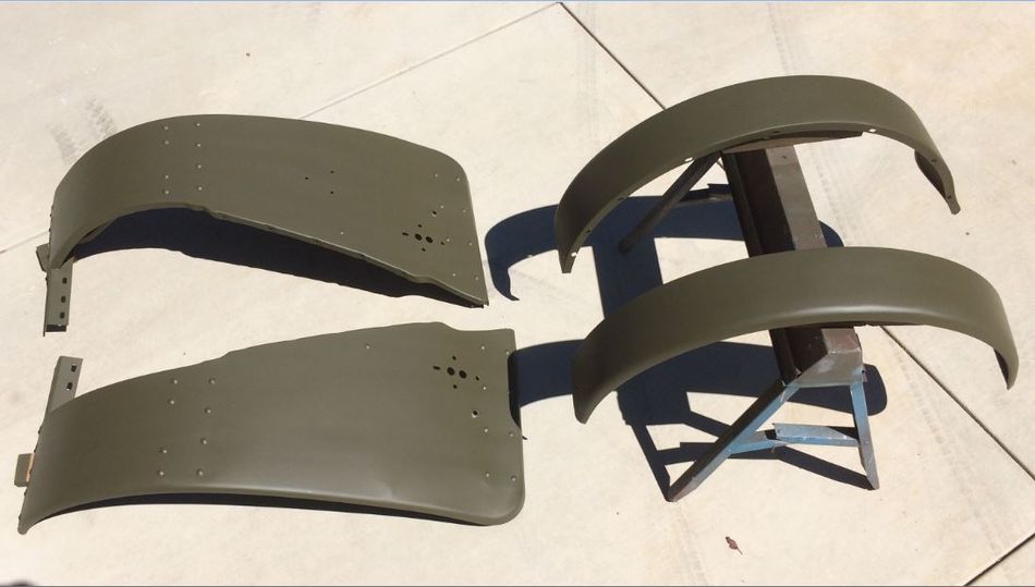

I have updated my $9.99 HF HVLP gun that I have used for the past 15 years with great results to a lower end DeVilbiss paint gun.
I have always used a regulator and adjusted the air pressure to about 30lbs, That is static pressure...with the trigger not pulled. It was an HF inline at gun regulator.
Well, the DeVilbiss gun came with a new at gun air regulator. When I went to set the pressure, It was always at 90lbs, which is what my regulator at the compressor is set at. When I pulled the trigger it would drop down to say 5lbs, or 15lbs, or wherever I adjusted it when the trigger was pulled. Yet the gauge would always go back to 90lbs when I released the trigger. Even if I screw it all the way down and no air came out when the trigger is pulled, the gauge would go back to 90lbs.
Hmmm...got me to thinking. I went back to my old gun which was set at about 30lbs and pulled the trigger...dropped the air pressure down below 10lbs. I have always painted like that. However, I have recalled turning the pressure up while painting before.
Now I'm thinking that I should pull the trigger on the gun and set the air pressure at 25lbs to 30lbs while spraying. So, long story short, should one set the air pressure at say 25lbs to 30lbs while the trigger is pulled and spraying, or between these settings before pulling the trigger? There is a very noticeable difference in pressure in the two circumstances.
Almost embarrassed to ask, but couldn't find an answer searching. Any insight is appreciated from those that paint and/or know what they are doing on how to set the air pressure on an HVLP gun or what the air pressure general should be. The instructions say not to exceed 30lbs air pressure.
