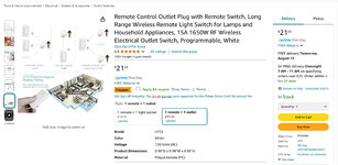

Remote control outlet
something like this
remote can be added next to your existing light switch - only down side is swapping out a battery once a year or 2…
something like this
Thanks. That looks neat. I'm old so wireless is not the first thing that occurs to me.

We use wireless for a few items -
Table lamps (with the 3 stage rotary switch) no more reaching up under the shade
outside twinkle lights ( like Xmas lights ) photo cell on and timer off or remote off
mood lightning in the garage led strip lightning (currently red color ) 3 separate lights on 3 switches on the remote
The key is to have an extra battery or 2 on hand…
