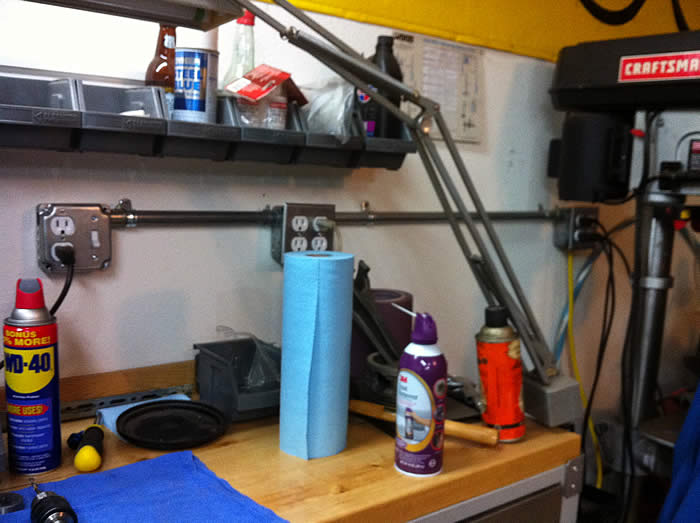

I use any I can find, do not usually plug hi power tools into them but for general minor stuff where its just so much easier and cheaper than hard wire as well as easy to modify. Most of these loads are low, drills have moved to a new home since and after I wire the welder booth I wanted a couple more switched outlets, just so easy and cheap to add a strip.

I started doing this in the old shop. The one here is rigged with a temp plug (yellow cord) since it'll be moved and re-done when the new shop is in operation. In the old shop, I used a bottomless Handy box over an existing outlet as the tie-in for the assembly. This way, with some fittings and a bit of conduit, I can whip up something that fits and if I change things around, it's easy to take apart and rework to a new layout. The new shop will have several runs like this, starting with a backless 4" box over a flush mounted 4" box. the backless box will mount a GFCI and adjacent plug, then have conduit runs extending in both directions as needed with outlets fed off the load side of the GFCI.
