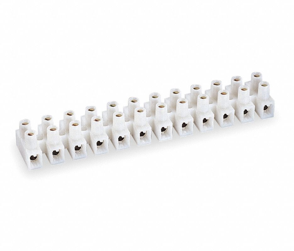

My plan at the moment is to delete the box on the left by installing this (or similar) enclosure on the interior of the house ::
https://www.platt.com/platt-electri...r/Hoffman/ASE8X8X4NK/product.aspx?zpid=307247
And extend each of the affected circuits into the box on the right using barrier strips ::
6YJ02_AS01
https://www.grainger.com/product/GRAINGER-APPROVED-12-Pole-Nylon-6-6-Barrier-6YJ02
Any problems with this latest plan? I don't feel like I see barrier strips used outside of low voltage, but I'm struggling to see a problem.

Use wire connectors instead of those terminal strips, but what is being done can trigger being required to use AFCI's.
C
capww8
Sep 6, 2013
94
The only problem I see with AFCI is the space requirement, but that's serviceable.
When you say wire connector, do you mean reg wire nuts? It seems like I'll wind up with a rats nest, what's the problem with a terminal strip?
Norcal
Mar 16, 2008
13,796
Those are crappy European style ones.
