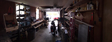

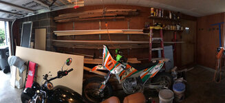

Below are some pictures of my garage as it sits as of October of 2018. I built the garage the way that it is before I had either bike. It worked great for the construction of the inside of the house. It's now time to rehab the garage to better suit my hobbies.
Goals:
My goal is to reach out to this community and see if you guys can brainstorm some layouts and ideas for my garage rehab. I need to be especially creative due to the size. Here are my specifications and requirements.
1) The space is roughly 22ft by 12ft.
2) I need the two motorcycles (2017 Indian Scout Sixty and 2009 KTM 450EXC) to be up front for easy parking access as well as easy removal when I need the space for a project.
3) I plan to expand the power tool selection. I currently have a 12" compound miter saw and 10" table saw. I plan on adding a table top drill press, (maybe) vertical band saw, and belt sander.
4) Various hand and small power tools will need stored either in drawers, shelves, or on the walls.
5) Optional: Ideally, I will be able to store the kayak, 21" lawnmower, yard tools, and garbage can inside the garage. These are wishlist items.
Ps. I have a few layouts drawn up, but I want you all to have a blank slate to brainstorm. I have purposely been vague in my wishlist so you all can be as creative as possible. Fire away on some ideas! Pictures submitted of drawn layouts are automatic winners!

A high shelf around the entire perimeter is a really handy thing to have. 2' wide is about right.
Zeke, thanks for the idea! I’ve just added pictures so you’ll see that perimeter shelving is going to be a challenge because of the windows. I definitely am going to try to utilize some overhead storage somehow though.

I couldn't agree more with the concept of a storage shed for the lawn and garden things (and the kayak - those take up a lot of room!).
Put as much as you can on locking casters - this way you can re-configure as your projects change.
From your first photos, I'd also recommend that you pick up a few gallons of white paint and paint the interior before you build or add too much to the space. Then get some improved lighting in there. Believe it or not that will make the space "feel" bigger as well as providing much needed illumination.
For a temporary solution, the wire shelving units that you can buy at big box stores are handy and can be re-purposed int the basement when you build something more suited for your purposes. Most of them have casters available - which speaks to the "moveable aspect above.
https://images.homedepot-static.com/productImages/52450743-6e77-49c7-bd27-8e92a44bae8f/svn/chrome-hdx-freestanding-shelving-units-hd18481302ps-1-64_400_compressed.jpg
Minimally, put up a higher shelf near the front of the space to hold your two brain buckets - make that a dedicated space so you get in the habit of always putting them away. That way you don't have to move them out of the way and worry less about dropping them.
