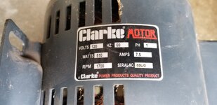

I picked up a free drill press. Previous owner said it needed a new motor. It's 120 volt single phase. 1700rpm. 7.5amp. Typical drill press motor. The motor was unhooked and sitting on the floor next to it when I picked it up. That's all I know about it's original symptoms.
Before I did anything I looked at the motor and saw the start capacitor had leaked so I assumed all it needed was a start capacitor. I replaced the capacitor with that of a similar value. I temporarily mounted the motor and turned it on. It just hummed and didn't turn. I had to turn the shaft by hand to get it going. Even then as it was spinning it was humming really loud.
I checked the resistance on the windings. The start winding is 0.5 ohms. The run winding is 1.5 ohms. Everything I read online says the start winding should be higher resistance than the run winding. Opposite of what I found on mine.
Plus, if you look at the picture, the start winding is black. I thought it was supposed to be black because it was so evenly coated black. But now I'm not sure. I think the start winding is burned up.

Yep, start winding is fried. If a split phase induction motor doesn't release the start winding after a few seconds it will fry. Usually caused by a bad capacitor or defective centrifical switch.

Yup, start winding definitely smoked. Either the smoked windings took the capacitor out, or a bad cap made the windings smoke.
FWIW: A friend of mine had a drill press with a bad start winding. He just disconnected the winding, and hand-started the drill press.

Odd motor, with 120 volt rating over the normal 115V, used for motors & does not have HP, or NEMA frame number.
Pretty sure that is a OEM motor, probably a Clarke drill press. Typical Chinese import.
7.5 Amps should work out to be about 3/4 HP.
