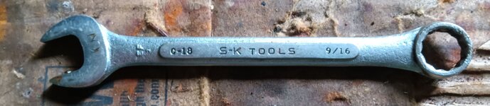

Hey all. He's a couple oddities out of my personal box. SAE is the smallest selection of items, as there isn't much I own that requires it. I was reading a little on Alloy Artifacts about SK. Trying to figure out a year range on these for funsies. I know the SK-Wayne is mid to late 60s based on the website. The diamond logo is old fashioned, but the wrench looks much newer than that. Anyway, just sharing to see if anyone has any info.

I did some research some years back before S-K got sold to the Chinese. These were the numbers I came up with
S-K Wayne 1962 - 1969
Dresser Industries 1969 - 1985
FACOM 1985 - 2005
S-K Independent again 2005 - 2010
Ideal 2010 - 2021
Sold overseas 2021
Thus my S-K socket set I bought in 1981 is a Dresser set.
The tool and box logos varied somewhat but establishing exact years for those is difficult to nail down. Hope this helps.
16,670
That’s good information. Even though Wayne owned S-K from ‘62 to ‘69, it took two years for the transition from tools marked S-K to S-K Wayne. The top wrench with the diamond logo is a price line wrench that I know very little about. If I see them at sales I generally leave them behind.
I was thinking it was disposing of the NOS on hand before the new stamping came on-line. But that's just a guess.
Just sad to see what happened to S-K tools. They were good, solid tools. Mine have never given me any trouble, save for a couple of sockets with peeling chrome. Heard they fixed that after a few years.
Pulled out my old set recently to do a small repair on my bicycle. Those 40+ year old tools didn't miss a beat!
