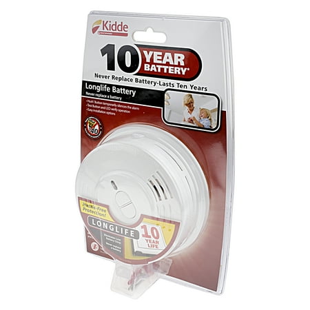

How about a 10 year battery powered?
I have them everywhere.
Bill
If you get into BRK's .pdf catalog (parent company of Kidde) they have a wide array of wireless detectors. To the point that they can call out, in english, the location on the "network" that is detecting the fire. Potentially more useful than all of them going off at once.

Since you are asking about a box, are these hardwired detectors ?
We have a program going on right now in partnership with the Red Cross and we install detectors like the ones Bill posted. They have a li-on (IIRC) battery and are good for 10 years, when the battery is dead, replace the detector as that's their life span also. We do it free of charge, so you may want to check out your local fire dept's FB page, city website or make an inquiring call.
