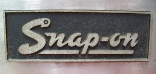

Sprayed three coats of paint on box and drawers, wet sanding after primer coat and every coat of paint with 1000 grit paper. I've found this works best for stuff I've done. Added the stickers to spice it up a bit. Painted the Snap On logo plate with the metallic silver paint, then sprayed it black, wiping the parts that needed to stay silver immediately off. Messed around with it a bit touching it up, and by no means is it perfect, but it's okay to me. Cleaned the drawer slides with some used evaporust I had sitting around, and after lubing them and putting the drawers back in, they slide like new. Locking mechanism is original, key is as well.
I replaced the stainless piece that runs the width of the box and is about 5" high. Took the old one off, it was only glued on in one spot. Had to use a strong magnet to grab hold of it and pull it off. Then I got a piece of scrap from a local metal shop that's always been cool when I've come by looking for a small piece of something. Trimmed it with my shear, lined it up with the holes on the old piece, and everything came out fine, fits like a glove. Got a bonding agent from Big Lots which worked perfectly. Very pleased with how it came out. :pimpflash

what "metallic silver paint" did you use for the emblem plates? that is one of the last things i need to do for the box i am cleaning up/restoring, and i haven't decided how to deal with it yet.
yours look great, so i am interested in how you did it.
