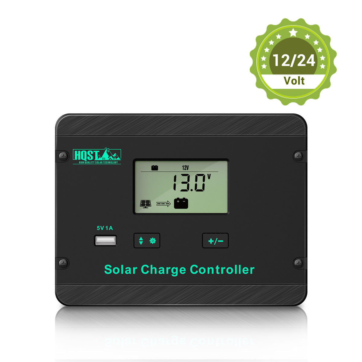

Coming back to this after a few months of use.
I purchased two solar controllers, this one
and this one
With each, I am using this Harbor Freight solar panel thrown on the dashboard
Prior to buying the two controllers I mentioned above, I was using this guy
which appears to also be sold under the "Schumacher" brand elsewhere.
So, to recap: Wanted basically a battery maintainer because at least one of my cars has a ~6 year old battery and I'm trying to get as much life as possible out of it. I do not have the ability to run a cord to the cars as they are parked on the street (working on that issue, but it's what I am working with for now). Trying to get a solar solution working so cars will always be ready to start even if having sat for a couple weeks. One (BMW, same car that has the old battery) also has high key off current draw so this seemed to make sense.
Problem: nothing has worked. The Harbor Freight charge controller failed fairly quickly, and the two others share a problem. I was hoping to be able to simply be able to throw the solar panel on the dash, hook it up, and be able to come back a week or more later to a charged battery. However they do not seem to work this way. What is happening is that the panels will charge the batteries during the day, but it appears that at night when the sun is down, the controllers draw the battery down so that in the morning the battery is actually lower than it would have been without anything hooked up. So, over a period of several days, although the solar panel is charging during the daytime, my setup is resulting in the car battery draining down faster than if I had nothing at all hooked up.
I am sure that the solution would be either a larger panel (which I don't really want) or a less sophisticated controller that draws less current to operate (similar to the HF/Schumacher one that I tried initially). Any ideas anyone?

Just curious but how are you determining the battery is charged and not charged in the morning? Are you taking actual voltage readings at night and comparing to morning? What are your voltages at those two times? Don't use the display on the controller either, take a reading off the battery with the controller/panel disconnected to see what is actually happening at the battery.
Charge controllers should list what their consumption is when not charging and it shouldn't be that much. Is it possible the solar panel is actually not producing enough to charge the battery in a day and it isn't actually ever getting charged.

The battery in my Falcon Hack was purchased in 2016 , load testing is showing that it needs replacing . But I've had it on the solar for a few years and it still starts straight away . The only issue was the battery drain due to lack of use ,which doesn't happen with the solar controller.
It actually managed to crank over a faulty starter motor until eventually I replaced that
Cheap controllers will drain current.
The Deltran solar battery tender has an internal circuitry [diodes?] to prevent back-feeding.
The only issue I ever had was poor contact in the cig lighter fitting [a twist while installing remedied that]
The charger wasn't showing fully charged.
Disconnect the charger and use a multimeter to measure amp draw across the battery ground [computerized cars usually draw about 1.8a for approx 1 minute then between 20ma to 80ma when the computers go to sleep.
Then measure the current input of the solar charger [across the neg wire]
@duneslider Correct! If the solar panel is too small the battery won't fully charge and at night the parasitic losses of the vehicle might draw too much.
It could be a simple math problem of only 4-6 hours of too small input vs 18-20 hours of draw.
