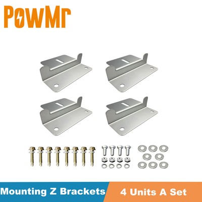

I have a four 220 watt panel system going up on the south hip of the roof of my shop soon. The south hip has a 10/12 pitch so the panels can mount direct to the roof without angle mounts. Its a stand alone 12v system with four battery backup to power the 12v LED lights and motorcycle charging ports. I already have the breaker combiner box and charge controller. So I just need to mount the four panels to the roof, up here in Green Bay WI.
With the steep pitch I figure the panels can just be spaced off the roof a few inches. This is a snow belt location, averaging about 50" of snow over from December to late March, but most often the snow on a unheated roof with a 10/12 pitch is minimal. My question is if anyone has a similar application of solar panels and should I plan for a higher offset for the panels off the roof. This style of panel mount is easy to find and reasonably priced:
Perhaps add a section of 2x2 aluminum tubing under each mount to space them higher off the roof?

You use solar panel racking to mount to the roof. That will have the panels 3-4" off the roof deck.

I don't think the distance between the panels and roof will matter in this case. With those brackets It's basically the same as a million RV solar installs of varying watt sizes. The air gap is mostly for cooling air flow.
Your 12/12 pitch should shed snow easily and at that angle should produce about as much Winter power as is available.
You would have to use UL approved racking if inspections were required. For off grid, not on your home you probably don't need to worry about that but it wouldn't hurt to check with your county/state.

You will need some sort of flashing where the mounts attach to the roof. Typically you mount a "post" every 4 feet, landing on a truss or rafter. Then you span the posts, horizontally with a framing member. Then you attach "clips" to the horiz rails, to hold the panels in place

Looks like those mounts mentioned in the first post get the panels about 3/4" above the roof which isn't a lot. You probably want more than that to ensure some air circulation between the roof and panels to keep the panel temperature down. And, as mentioned, you want to do a good job of flashing as that has been something that was often overlooked in installations in the past. I'm in Western Wisconsin, and I have found (over the 40+ years that I have been using PVs) that my PV system has put out the most power on sunny but cold February and March days when there is still snow on the ground which reflects more light on the panels; the efficiency of the panels goes up as the temperature goes down.
