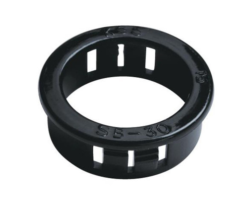

Screen Shot 2022-12-07 at 10.11.28 AM.pngWell I did find these from Bridgeport guess that's the easiest option. Just require a thin blade cut to split it.

Definitely not listed, but this would at least add some protection

It's comical how everything that gets asked on GJ becomes a contest to see who can come up with the most difficult way of doing something. Other than taking all of the wires out of the panel and bringing them back in in sets of one or two cables through approved clamps, connectors, or bushings, there are no code compliant solutions to this problem. Cut this in half, glue that together, zip ties this, and on and on and on. All he needs is something to sleeve the hole the bundle of cables is running through and I'll bet everyone on the purchasing side is happy. A snap in bushing is all that it's going to take. It will require a slit cut in it to get it around the wires, but that can be done in multiple ways from a cut off saw all the way down to a lowly pocket knife, depending on how difficult one wants to make that part of the process, personally, I'd use my dykes and be done since that would be the fastest.
These are just examples. 1/2 and 3/4 should be available at about any box store. Other sizes up to 2" and maybe larger should be available and in stock at an electrical supply house.
