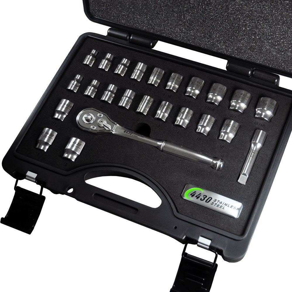

Hello, everyone. I apologize for making this my first post, but I have a time window to meet if I'm going to return the following socket set and was hoping to gather some informed opinions.
I have a thing for stainless steel... Wait, scratch that. I have a passionate hate for rust. So when I spotted the following stainless steel sockets available online, I wanted them. What I didn't want, however, were irregularities on the inner perimeter of each socket...
They resemble bad welding jobs or something. Is this a sign of poor quality? In terms of the tool-making process, what could such irregularities indicate?
Thanks for listening.

What brand are them there sockets? Do they all look like that or just the one?
The irregularities only occur in socket sizes 1/2", 12 mm, and above, for a total of 18 of 26 pieces. The maker seems to be relatively new, which is why I am cautious. They are called Pacific Professional Tool Company and are based out of Taiwan, though literature accompanying the set mentions American supplier Carpenter Technology as their steel source.
Looks to me like the marks of broaching. It also looks like a FANTASTICALLY well made tool.
Thank you for the input. The irregularities seem to be of excess material (resembling excess patches of solder/weld), not an absence--though the excess is very slight. ("Cracking" was the wrong word; I apologize.) Could this still indicate broaching or skiving marks?

Yeah, I'd say they look good. Broaching tool may not have been as sharp as it should have been and may have rubbed, rather than cut, portions of the broach. I wouldn't be worried, it happens.

doubt those markings will influence tool ability to spin fasteners...
one thing you must have in mind , Stainless tools should be only used on stainless or non feritic materials, brass, aluminium or the like , and they are WEAKER than a common tool in crom vanadium .

Hot forging,cold forging,powdered metal process,casting----
I guess the choices as to how to manufacture are different with stainless as opposed to tool steels--I guess brands such as Armstrong Wright S*K KoKen and Snap On -and China tools have preferred ways of making their sockets

This looks like the kit, $263.00

They're appropriate for turning stainless fasteners.
This is one of the reasons I had. I also plan on using these in a saltwater environment. Other possibly reasons to buy stainless include the ability to autoclave or use certain detergents in order to meet sterility requirements.
I appreciate the words of caution and look forward to using these appropriately, as I have decided to keep them. I come from a Ko-ken/Vessel background, so my experience with Snap-on is limited, but both the ratchet and sockets feel good in my hands and rock solid while fastening.
Thanks for curing my cold feet. In a year or so, I might be able to recommend these. In the meantime, the SAE set was $125 on eBay for anyone willing to give stainless a shot (though I cannot locate that auction now.)

Stainless tools for stainless fasteners are to avoid contaminating the fastener with steel particles. If you rub stainless with non-stainless steel, it transfers minute particles of iron to the stainless. When those particles rust, they will cause the stainless steel to rust also. This "cancer" of rust continues to grow and damages the stainless steel.
This is why you never want to clean stainless steel items with steel wool.
