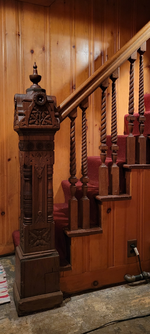

The Bean
Dec 24, 2021
1,885
Delaware Valley (SE PA)
It's a shame you had to cut out an important part of that classic turning shape. What do the rest of the balusters look like? Here's a pic of some antique stair parts leading to my man cave. The newel and the railing with balusters are not from the same original stair but they work. Hope yours turns out well.
