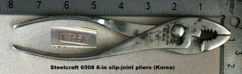

When we get to the post-war era, "Steelcraft" is coming in from all directions. A quick search turns up "Steelcraft" products from Japan, Korea, Germany, West Germany, and "British Zone" Germany. And I didn't even have to go very far down the rabbit hole to find those.
Steelcraft 10-in pipe wrench (Japan)(Ebay 124258141326 01).jpg Steelcraft 4007 hole-saw set (Japan)(Ebay 264516510461 01).jpg
Steelcraft 6508 8-in slip-joint pliers (Korea)(Ebay 154126083354 01).jpg Steelcraft wrench (Germany)(Ebay 324545991327 01).jpg

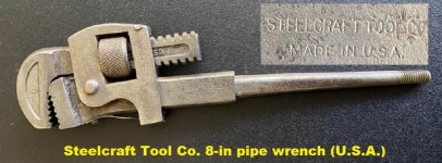

To further add to the confusion, there were/are "Steelcraft" products being made in the U.S.:

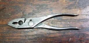

Below (Pic 1) is my Steelcraft collection. :pimpflash :D
The spiral push-drill and the chisel (see Pics 2-5) are both from the 1946-1949 "GERMANY BRITISH ZONE" era - which is pretty much the only reason I bought them.
The 3-piece extractor set (see Pic 6) in the handsome, colorful, painted wood twist-off case is pre-war, and I would hazard to claim from the exact same timeframe as the drills in the same case in your ad above. It is a good illustration of how their not exactly scrupulous practices were established early. The case is marked STEELCRAFT and MADE IN NEW YORK, N.Y., their home address, but the extractors are marked "J.P.F. Inc. WRCSTR, MASS". Which is precisely the kind of thing the FTC would fine them for much later in the 60's and 70's. I picked that set up because it's just the kind of obscure, peculiar, and yet relentlessly historically significant kind of item I cherish.
All three flea market finds.

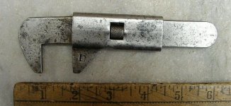

Had a chuckle and thought of you when I spotted the SPIEGEL BROTHERS name (see Pic 4) on these at the flea this morning, 4.c. :) The worn COO is definitely Germany. I think I have a Steelcraft Occupied Zone that looks just like it somewhere around here.
13,476
Just wanted to toss out some thanks for these catalogs. I was poking about in the world of Perfect Handle type screwdrivers, and found one with the SBCo logo in a triangle. (Missed Spiegel Brothers in a visual scan of this list, since SteelCraft was on the left margin) Lugz wisely recognized the logo, and pointed me here.
I also found a visually similar dinky drill press to my Keen, presented elsewhere.
Thanks guys, we really appreciate the resource tools Mark and 4.c are supplying.
