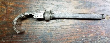

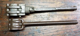

^ There are a lot of different types available. Some employ a thick "web" strap (think super-thick Army belt.)
  • Lowell Wrench Co. Warnock strap wrench (patent 1294515)(ebay 134213469901 03).jpg
