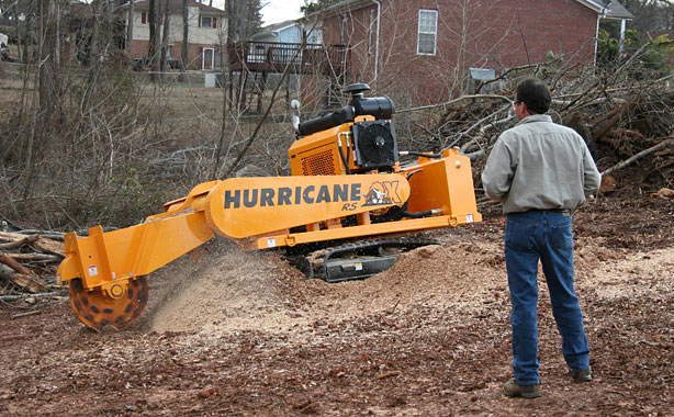

UPDATE: New stump grinder came with the proper tracked machine and made short work of all the remaining stumps. Looked something like this.
Grading and compacting to start this week if the rain stops on Wed. Good suggestion on the termites as they are definitely around here.
