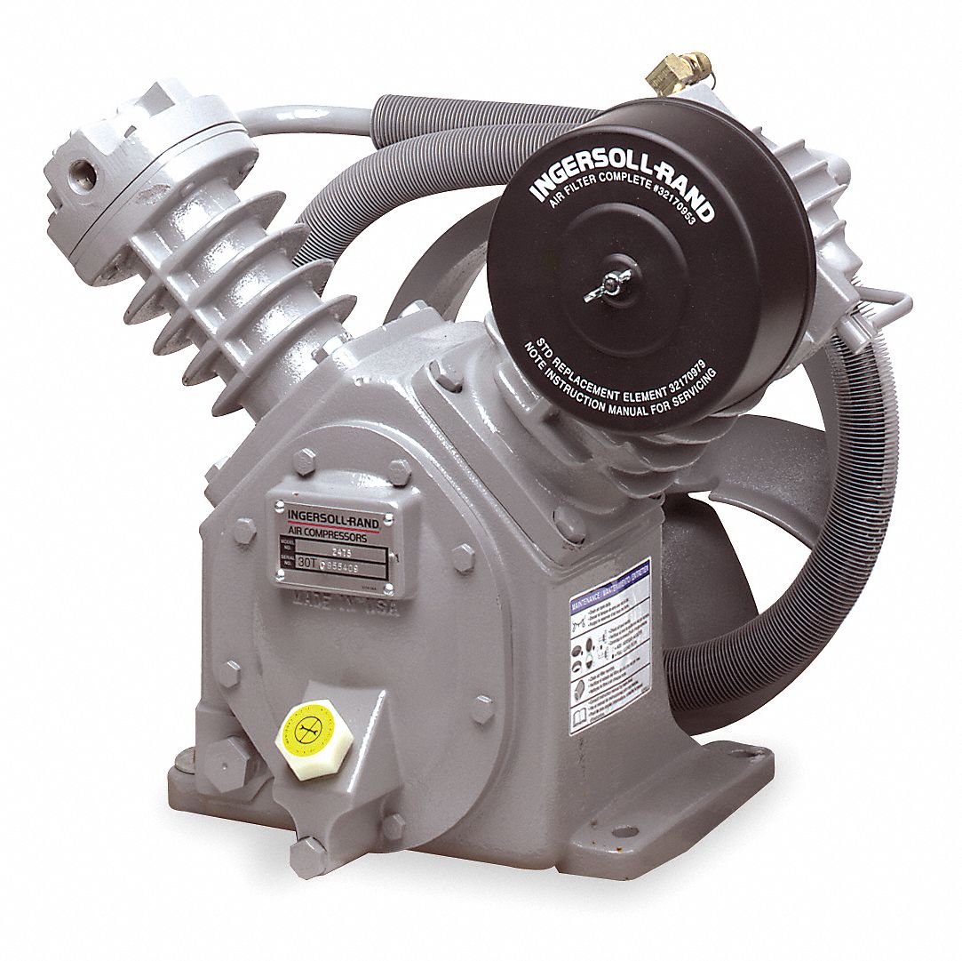

I have air tools that draw 30-40 CFM and have to downrate compressor output about 26% due to altitude. 200 pounds is not as much as some. The Jenny U pump weights about 340 pounds and is rated for 7.5 HP at 610 RPM to produce 27 CFM @ 175PSI. At 10HP at 760 RPM it'd make 35.

I tell you what next time I have the Ir 2475n7.5 runing I will check the ambient temp and 1st / 2nd stage temps and will post some data and see shall see
I really have seen no issues in the higher rpm system it like a gas vs diesel motor they are both reliable in today's day and in the end they both last a very long time...
About the water in the system on average
we see less than a 4oz in a 12hr day

That would be some nice data. I have an old dual stage Champion that runs around 175F. It only turns 700 RPM. My single stage Emglo's run around 320-360F and turn 1140 RPM. I'm thinking of replacing the Champion pump with a 2475 for more air. The flywheel of the 2475 is small enough it should fit just fine on the top plate of the tank. I don't have the clearance for a 16-18" flywheel.

The W/WU pumps are rated about 18 CFM w/ a 5 HP motor @ 175 PSI and weigh about 175 pounds. With a 5HP motor they turn 750-770 RPM.
The U pump is the next size up. It's rated 27,35 CFM @ 175 PSI w/ a 7.5,10HP motor and weighs 275-350 pounds. RPM is 610,760.
By the time you are up into the U and T pumps there is no constant run so no head unloaders like in the smaller ones.
The "U" in the KU or WU pumps references the head unloaders for constant run operation. In that case there is a pilot valve instead of a pressure switch. The pilot valve has a line to the head unloaders to hold the valves open when air compressor operation is not needed/its just freewheeling.
