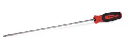

Another favorite: Snap On SSD 1416. World’s best poking stick. Just the right balance of flex and rigidity. Pictured next to my 18.75” long 1/2” drive breaker bar for scaleIMG_0723.jpeg
