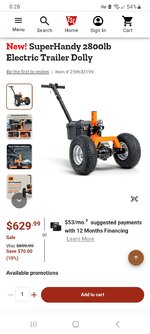

Superhandy trailer dolly
moab11
Nov 22, 2015
582
Thunder Bay, Ontario
Love the price, but seems pretty under powered or the specs are very conservative.
A 2800LB trailer isn't hard to move with a non powered dolly, I'd expect a rating of 5000lb at least.

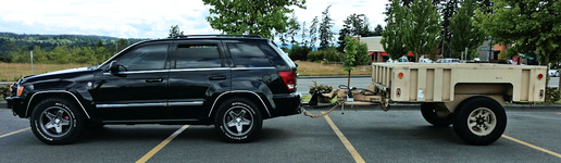

I'd love to have one for my M1101 trailer, but I'd have to fab up a pintle for it. The place I'm parking it is kind-of a pain in the **** to maneuver the trailer into with the jeep or the HMMWV.
Picked this up many years ago on the gov auction for $750, not bad for a $8K aluminum trailer.
