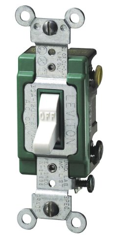

I have a 3HP rolair compressor that is wired directly to the panel right now. To turn it on and off I have just been using the breaker. I would like to put a switch in close to the compressor to turn it on and off instead of using the breaker.
Something like this, http://www.grainger.com/Grainger/SQUARE-D-General-Duty-Safety-Switch-1H252?Pid=search
It's a 220 compressor and the motor plate says F.L.A. 14.4-15 amps.
Don't know exactly what I need. Would like to be able to just pull the handle to turn the compressor on and off instead of using the breaker.

If you don't shut it off frequently while it's running, Menards sells Leviton standard wall rocker switches in both 20A dual-pole and 30A dual-pole.
Runs ~$30 for the 30A and ~$22 for the 20A last I checked. I bought one for my 2000W halogen, it works nice.
I found those and bought the 30 amp instantly. It is very comforting to know that I can throw a switch that breaks both legs and can handle motor start-up current with no problem.
Now, if I could just remember to turn it back on in the morning!
Edit-I turn the compressor on and off in the morning and in the evening. Once in a great while, it will kick on when I throw the switch, but it's not very often. If it starts to become intermittent, trips the breaker, or starts to smoke, I'll spend another $35!

That first switch shown should be fine.
The green Leviton "spec grade" 30A switch is NO GOOD.
The current is NOT what is not the most important part of the switch rating, and neither is the motor full load starting current.
You must have a switch that is rated for the Horsepower of your motor. The 30A spec grade switch is probably only rated for 3/4" horsepower, and is really designed at that 30A rating for resistive lighting or heating loads. Using that switch on your compressor repeatedly will trash it in short order (it will trash the breaker eventually too), if you turn it off while the motor is still running.
That's the catch. The switch posted by the OP is probably rated for 10 or 15HP, and has the contacts required to be able to shut the motor while it is running. That's exactly what he needs.

The 30A is rated for a 2 HP motor, but as I said when I recommended it - you would want to shut it off when the compressor is not running... with that use or the occasional break when running, it'll still last a very long time in that application.
rlitman
Oct 18, 2010
24,742
Long Island
2HP, ok, yeah, that's pretty close if you don't frequently shut it while it's running. The last time I looked at one of those though, the one I saw was rated under 1HP.
Besides, that SquareD switch has SquareD pricing.
I paid about $25 for a Cutler Hammer 15HP rated version of the same thing.
I got it at Lowes right next to the air conditioner disconnects. Mine happens to be the raintight version with a sliding switch on the inside (instead of the exterior handle), but whichever is cheaper will do.
Since it comes with the box, it's not going to cost more than paying for a metal box and a spec grade switch anyway.
