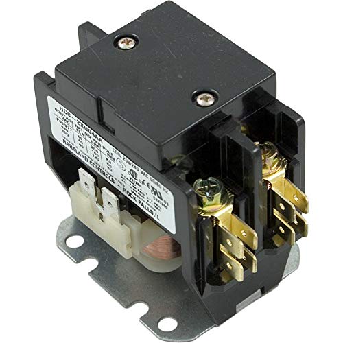

probably would not be considered NEMA friendly but maybe 3 50 or 60 amp amp 230V contactor switches triggered by a 24V 3 way switch, or 3 separate on- off toggles. You'd need a grounded box safe enough not to accidentally get damaged if something banged into it, 3 contactors, a 230V supply and ground, the trigger switch(s), a 24V source such as a 24v transformer, 3 sockets, and the patience to make sure everything was installed carefully and in a way it could not ever short out. Also the box would have to have an exterior disconnect on it. But it could be done. I understand that plugging and unplugging has its own risks. Otherwise 3 separate circuits and cords. All the welders I've known have a different station set up for each welder type, and they rarely went back and forth between types on a job. You'd have to choose a switch that did not allow any chatter between contactors - meaning a rotary might not have a clean on-off sweep so that two contactors might still be engaged simultaneously for a split second.
You could use something like this to switch each contactor. But you would have to build it in a sturdy case because nothing like that appears to be out there.
contactor example - just make sure it is for at least 50 amp.
