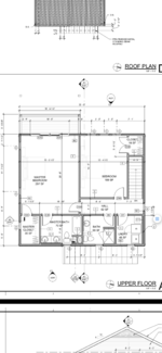

I am in the stage of building a lake house that I need to decide on a system style.
I have a 2 story with walkout basement. 2x6 walls, zip system r19 walls and r38 ceiling insulation. Main floor is basically wide open with a small closet and pantry in the middle
Of the back wall that I can run ductwork in from the basement to the top floor.
Running a calc it’s showing I need a 2-2.5 ton ac system and 37k btu heat. I was planning on doing a heat pump.
House is 2,700 sq feet. 900 a level. I was not very happy with my first 2 story house using one system. As the upstairs was always a solid 3-4 degrees warmer. But it was 2x4 walls.
Is there a downside to doing a traditional hvac on the main level and running a two headed mini split up stairs?
There will be 2 bedrooms, 2 bathrooms and a laundry room on the top floor. So im not sure how well the bathrooms will be cooled with a mini split being in the room with no vents in there.
How much of the closet will the supply and return ductwork take up? How horrible would it be to put a system in the attic?

Attic is the worst place for ductwork and/or equipment, unless the roof is spray foamed and the attic is then conditioned space.
Temperature differences between floors is almost always a ductwork problem, as in ****** design.

It can be a pain to balance out a two story home. I get the idea of mini splits but I am not a fan of then in new construction unless you go with an air handler style and duct.
You can deal with the imbalance with ductwork. Put a full size returns on both floors. Each large enough to satisfy the ar requirements of the furnace and put balancing dampers in both so you can adjust the return air flow. Put the second floor return near the ceiling to pull off heat in the summer.
Make certain your supply ductwork is large enough. I generally figure out what size is required, then go up one size. You can always close down registers. It is difficult to increase duct size afterwards.

I would do two systems and have both air handlers in the basement. (nothing in the attic unless it is conditioned space) Mini-splits are great for open areas, but I would run ductwork to each room. Heat pumps make a lot of sense, but I would go with a hybrid system with gas or propane back up heat.

Does anyone have an idea of duct sizing for a 900 sq foot floor? I know it’s pretty general question but looking to see if I have enough room in the bathroom to get duct work upstairs. I have about a 18-20” space to run it through.

With the information provided You will need about a 10x16 duct. I would recommend an over sized return duct too. so at least double that.
Not knowing the situation, but you need to make room for duct if you want a properly running, comfortable system.
I generally sized residential duct for 1 CFM for 1 sqft of floor space and I would be over sized.

Otherwise, I would suggest paying someone to do a load calculation, duct design and equipment selection. Given the blueprints and specs, this could likely be done for under $1k. Then you will have a set of good drawings for the HVAC. There are companies that do just this- so no conflict of interest with selling HVAC services. Some towns near me require this (the load calc, duct layout and equipment selection) as part of the permit process.

Thanks. I have someone coming on Tuesday to spec everything out. I was just trying to see if it was even possible to get the temp difference between floors down to a degree or two or if the consensus was to just go two systems, or hey your going to need a 3’x3’ run for ducting etc.

Since this is a lake house (primarily summer use?), what is your priority for good temperature balance between floors - heat or cooling?
I have my A/C system in my conditioned attic and I cool two floors of about 650 sq ft each. It works great in hot weather because it cools better on the 2nd floor than the 1st (great for sleeping), but the cool air naturally drops down to the lower floor, so it balances out.

Cooling would be my preference. We go down in the winter but not that often. I usually keep the house at 62 all winter so the drywall doesn’t crack. I didn’t really think about putting the unit upstairs in the laundry room on the top floor and just force cool air down. That’s actually a good idea.
