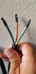

Hi, purchased a TCL TAC-24CSA mini split air condition unit that I'm having doubts as to how to wire the main power line to the outdoor unit. The power cord has 3 wires: Brown (L), Blue (N), and Green/Yellow (G).
The unit is a 24000BTU and rated 240V. How do I connect the Live wires when there is only one Live wire on the power cord. (Pics attached)
Any help would be appreciated.

Seems like it’s so bad they even labeled it wrong ?

It is amazing how ubiquitous that font is on crappy Chinese diagrams.
Plus it is riddled with spelling mistakes. Not very confidence inspiring. Normally I would suggest an email to their tech support, but Google translate will probably mess something up

It takes 240v. Ignore the fact that it says neutral. Just wire your second hot to it.
When they wrote the instructions nobody bothered to figure out that in the US we have 240v center tap power.

240 VAC from breakers- L & N. Ground from breaker panel to outdoor unit to the chassis ground. The three wire power cord just feeds the indoor unit from the outdoor unit.

I've been told that in addition to supplying the indoor unit with power, that the wires also carry communication between the two units using a high frequency signal. This means no poor splices or terminations in the 3 wires.
