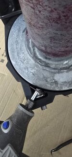

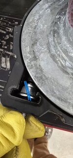

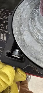

Stainless nut seized on cut off bolt. Cast aluminum winch housing.
Thoughts?

Small die grinder wheel - possibly Dremel to cut through the top of nut. If nut can spin, do the same as on top (and you are done) if nut cannot spin. A) use wheel to flatten nut so it can rotate or b) use heat and HD screwdriver with wrench to open the slot you created in the nut enough to extract the shaft.

What does it look like from where the bolt is coming out from?
Tef-Gel is your friend when it comes to stainless hardware.

The nut is seized on the now broken bolt. You will never be able to unthread the seized nut from what is left of the bolt, it's basically fused to the threaded section now.
If there is any way to hold the nut and have as much of the threaded section of the bolt stick out as far as you can, grab it with some vise grips and twist it until it snaps off.

skeletonizer
Sep 25, 2008
1,320
Got it with the Dremel. Pretty painless, just a little paint scuff. As you can see the wheel isn't deep enough to get the bolt so I had to attack the nut. One diagonal slice down to the threads and it then spin off. 1000004035.jpg1000004036.jpg1000004037.jpg1000004038.jpg
