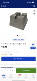

When I built my shed I used these blocks to keep it off the ground. We built the deck on the blocks and then the shed on the platform. Almost 30 years and there is not any of the siding rot like yours.

Thanks Gurp. Trying to keep it organized ... Staying focused on the shed's purpose.
Great info Captain14 . This shed came to me free and was already rotted at the bottom. The dirt was right up against the wood at its original location . I replaced the really bad panels but was trying to salvage as much as I can and just stop the decay. My free shed has already cost me over a grand ... Moving it and fixing it and insulation and drywall ect. .... But thats still a good deal if I dont go crazy... :)
I could raise this one but for sure the next one will be built higher off the ground

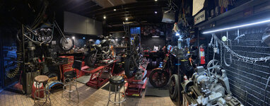

Later, we all rode out to a spot in Brooklyn with a shop and bike storage for customers. They were serving up beer and hot dogs, and by evening, they’d started a fire in the outdoor courtyard/parking lot. At one point, my friend Craig’s beautiful blue OIF (oil in frame) BSA broke down right there in the parking lot. A few of the younger riders had taken it out earlier, while Craig and I held down the beer table. Turned out to be an electrical issue, maybe a grounding problem; hard to tell exactly with two or three people working on it, but which ever was the final fix, he got spark and was back in business.

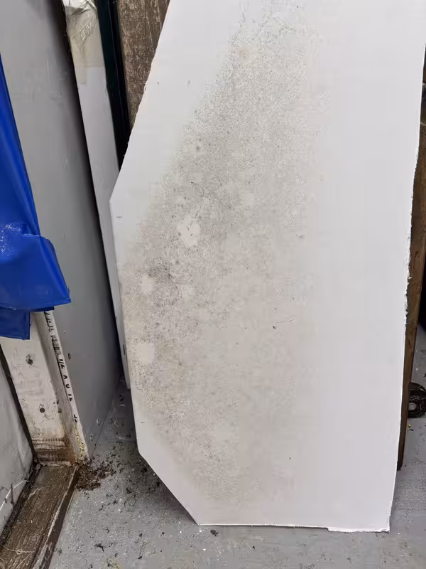

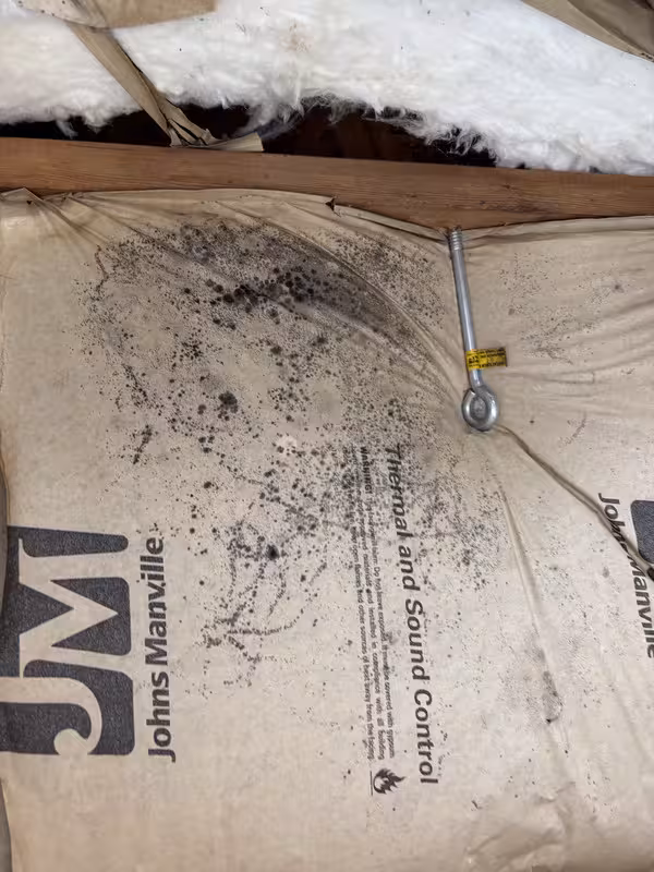

So having the shed professionally insulated didn't turn out to be the best choice I guess... Too air tight... I started seeing condensation on the paper side of the insulation last summer... Probably happening much longer but I didnt see it. Now there is patchy mold on the paper near the eves... So I put 6 - 3 inch vents in the eves and removed the drywall and insulation there in the eves. So I should have air flow now. I sprayed all of the mold areas with bleach.... I hope I can stop here and not have to gut the whole thing ... That was a lot of work getting it where I wanted it but I also dont want to get sick from mold. Thoughts?

I was also happy to see that the mold mentioned previously is completely gone where I sprayed it with bleach... I think it maybe alright now if I can keep the condensation to a minimum ...
