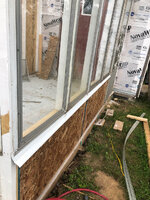

I actually started the build last September. My wife and I had parted ways with our business partners (her family, kinda messy) and I needed a way to keep the mind off of things. I had been planning to build a full garage at some point, but hadn't gotten it together and wasn't sure with the rising material prices. So with those two things in mind, I figured this would be my distraction shed.
I was fortunate to still be working from home at the time so I managed to get most of this done before we went back into the office in November. I've only ever built a treehouse before this, but I found a plan on the internet, modified it a bit to what I had in my head and slowly started putting it together.
Here goes. Here's my side lawn. We had most of the trees removed and some fill brought in to bring it up. I rented a post hole digger and found out that the fill that was brought in was mostly large boulders. Spent the full weekend getting 6 holes down about 4 feet. Had to chisel a couple rocks to get them out of the holes
Ended up mixing the concrete in a wheelbarrow, string lines are probably not perfect either but it went well enough to continue.
