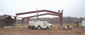

Doing a storage building. I got stuff,, need more space.

Wow.... thats gonna be a MASSIVE friggin' place! you 2 guys moving around all that big heavy stuff yourselves? I'm impressed!

Ya, white "stuff" here are todays.

I use it a lot for everything imaginable, it is very useful. I knew I could set this building when I bought it a couple of yrs ago.

Definitely earning its keep around there. How deep did you have to dig your footers? While building that is it necessary to leave the bolts loose til it's all together in case of adjustment? Or is everything lining up pretty good as you go? I had a friend that built one of those hangar type metal buildings and he tightened all of the bolts as he went, then got to the end and couldn't get the last few pieces to line up :lol_hitti That's going to be one big building.

We were squaring the main bays yesterday, we wiil square and rack the bracing bay quite acurately then erect the rest of the steel. I started the erection on the end bays but it got dark, one of my guys spent most of the day plumbing and bracing one of the main bays. After the end bays the lean to steel will go up, with another day or 2 we would have the main iron up. It took me most of yesterday to sort some stuff and move it around. I had a couple guys gone for 2 days and that slowed things up considerable. I should have had this done a month ago but had some un foreen delays elsewhere, I would be finishing about now. If we get a couple weeks weather break things will work out.
