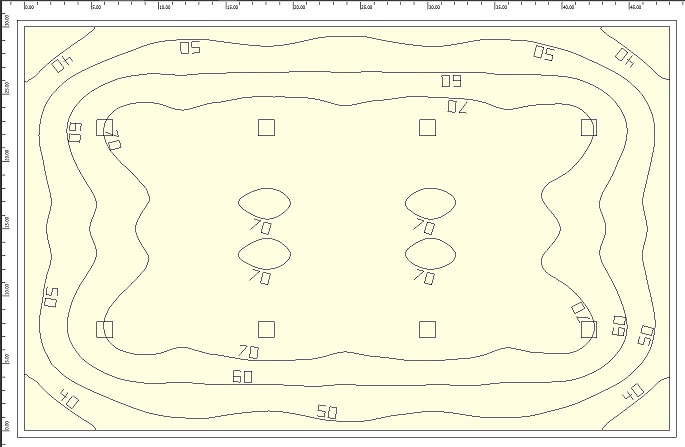

My shop will finally be up within the next month or so and I just happen to run across a SUPER deal on these .http://centuriontechnologies.com/store/outdoor/leotek-lcn3-double-canopy-led.html
My shop is 30x48 with 12ft sidewall and open span steel trusses. I bought 8 of these @ 13100 lumens a piece, they have a type 5 light distribution. I thought it should be plenty of light with a few of the cheap box store 4ft led's right above various workbenches.
What do you guys think of this plan??

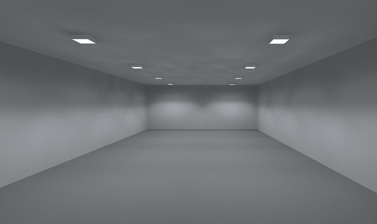

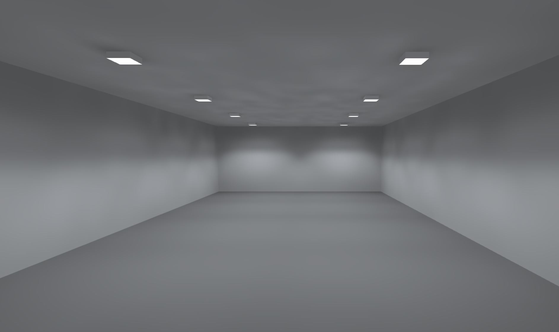

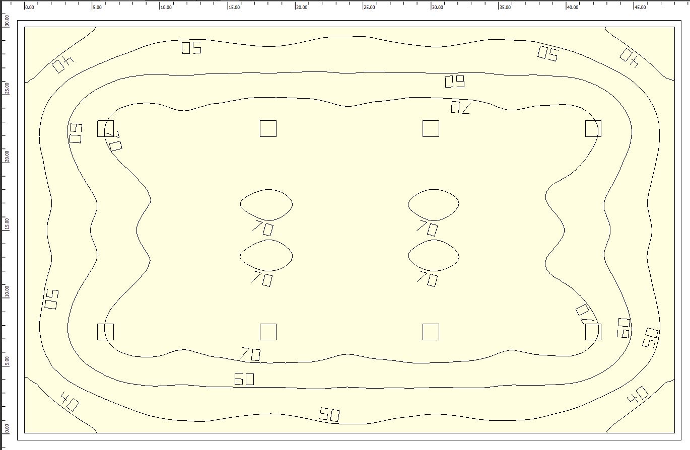

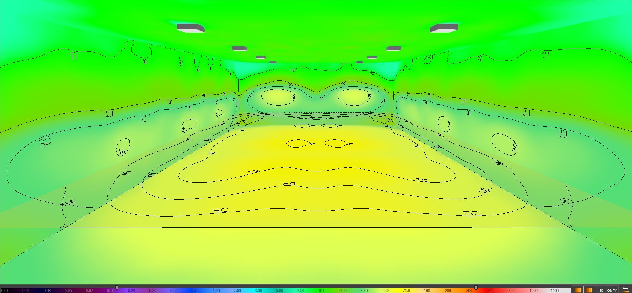

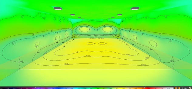

Here's the isoplot with 8 fixtures:
Pics linked to larger images
Here's the Dialux PDF report (link)
FYI: You would need 15 to reach 100fc @ 30" workplane.
Pro: $81 each for 13100 lm is good.
Con: The conical beam spread of these outdoor canopy intended fixtures give you dark ceilings and walls creating a cave effect.

Thank you Platonic! With the 4ft leds right above my workstations I think it will be fine. I guess I'll find out soon enough. Anything is better than nothing.

Platonic, thank you very much for taking time to do that for me. The visual is great. Obviously I'm being as thrifty as possible as I don't really have any extra money to speak of. This will surely be fine until a later date then maybe I can upgrade to some nicer fixtures.

Here's a pic of the lights on. Its pretty much how the rendering from Platonic showed. Which is fine by me, I'm used to much worse.

End result pic looks good. Maybe a little glare, which is to be expected.
