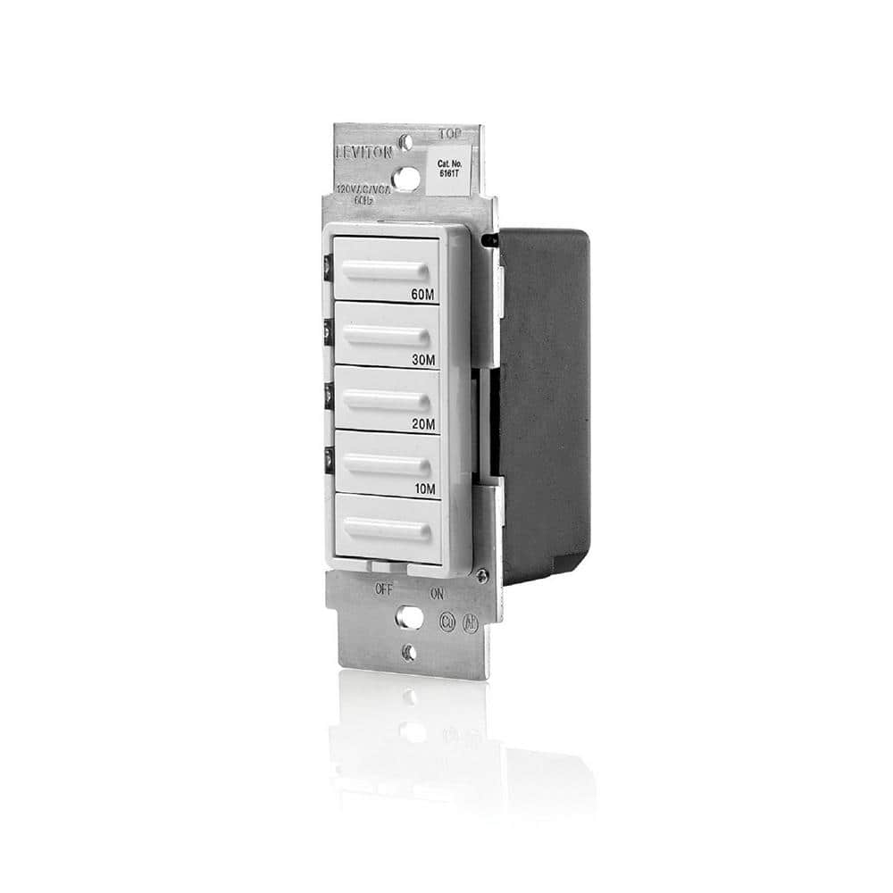

I want to install a timed switch so that the fan in the bathroom will stay on after taking a shower for a period of time. The switch for the fan also turns on the bulbs over the vanity and the GFCI outlet. This switch is in a single metal box, no neutral in the box, and ground through the metal box. I've narrowed it down to an electrical switch and a mechanical switch. I'm kind of leaning toward mechanical as it has a higher capacity and since it's mechanical I shouldn't have any compatibility issues with whatever bulbs I use or any minimum load requirements.
These are the two I've narrowed the choice to:
I'm thinking that after taking a shower I'll just turn the knob back to 60 minute mark and that should be more than enough time.
Anything I'm overlooking? Anyone use any of these? Advice?
Thanks.

We used to use the mechanical turn style.
New house, I used the 2nd multiple pushbutton style. I love it. Put one in every bathroom.

I use this one. 5 in my current house, two in the last one. No issues at all
Leviton 500-Watt 60-Minute In-Wall Digital Timer
SKU# 202051145
If you need more capacity, this is 1800watt

Yes. If you have a neutral, you can use basically anything. If not, you have to get a compatible one

These switches eventually do fail. On the circuit board, there is a resistor mounted in proximity to an electrolytic capacitor. This causes (heat) the electrolyte to break down. Planned obsolescence. Happened to me more than once. Still like the concept, still use them.
mike93lx
Dec 9, 2013
38,398
Richmond, VA
Everything fails eventually.
No way I am listening to a mechanical timer ticking away in my bathroom, so this is it.

I installed the "GE" unit. The metal on the unit was engraved with the "GE", packaging says UL Listed. Made in China of course. It works. I tested it at 5 minutes and 60 minutes and it did those and shut off. Seems user friendly. Just push the big button and it'll go on for amount of time it was previously set for. Push the big button again and it turns off if you don't want it to wait for the time off. If you want to override the timer you need to keep the button pushed for 5 seconds. I don't think I'll do that. When I take a shower, I'll just let it go.
Amazon had it at my door in less than 24 hours and on a Sunday! I picked free shipping. I thought it was coming later this week, surprised me and sort of forced me to install it today.
