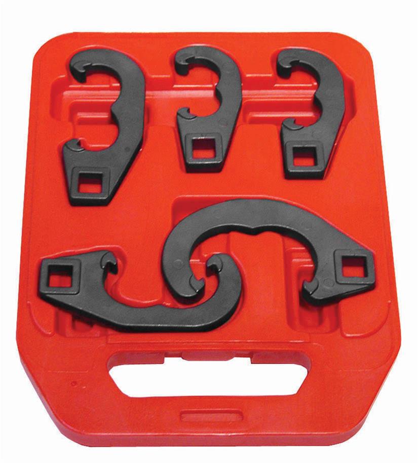

I have some working coming up on my F350 with a Carli lift . I've done this in the past on other 1 ton trucks with a pickle fork and BFH but I'm getting too old for that.
Looking for suggestions on a front end service kit (currently looking at OTC) and whatever else might be useful. I'm not sure if the tools that come in the kits are beefy enough for F350 components or not.
I will be:
Replacing the drag link
Replacing the tie rod and ends
Adding radius arm drops
Also I will need to remove one bolt on the track bar
Thanks in advance for your help.

I have a KD tools (Now GW) service set that has been perfectly adequate for my 2 super duties and any other vehicle I have used it on for the last 12 years.
The only thing I would do differently is buy an OTC 7503HD tie rod end puller as that has been my absolute most used puller and I eventually trashed the original that came with the set.

I have the full OTC front end service bundle that consist of the 6295 and 7249 kits.
The 6295 has the 7303HD in it.
I have never once regretted spending the money for it. Most of the time while using it I recall how I used to despise front end work when I had a pickle fork.

A kit is worth having because every puller has an application that it works better than anything else. I have a pretty wide variety of vehicles so I have used every puller in the kit I just used the tie rod puller (7503 equivalent) the most.

Thanks everyone. I ordered the OTC kit and also picked up a 3/4” breaker bar, ratchet and torque adaptor.
