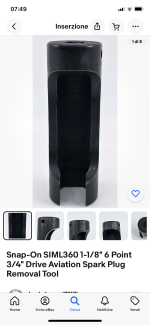

I just happened to see this socket on eBay yesterday. It is listed as SIML360, which I recognized as the number for an extra deep 1 1/8” impact socket, so I figured the seller typed the wrong item#. Nope. I zoomed in on the picture and it is indeed the same number. Have they recycled item #s in the past? This is the first time I’ve ever seen it. IMG_6523.pngIMG_6524.pngIMG_6546.png

looks like they're the same socket, but the ebay one has had material removed. Could be user modified, could be snap-on making it for a customer (In the past, they made lots of tools for assembly lines, many special), could be the market is small enough they don't bother restamping it.

From your pictures the cutout socket is a 360 and the last one is a 320.

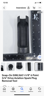

The Snap-On site shows a 320 in the photo, but a 360 is the 1 1/8” version of the same socket. I think the post above is correct in that it is a modified version of the SIML360. The eBay listing for the odd socket shows it next to a ruler and it is indeed 5 inches, just like the SIML360. Here is a picture of my own SIML360 for comparison. Gotta clean that rust off. The eBay one says it’s for aviation spark plugs, that’s a huge spark plug. Not sure why I find this stuff interesting, but I love it. It’s kind of like the tool geek’s equivalent of arguing about inconsistencies in Star Trek. IMG_6549.jpegIMG_6550.png
Spark plugs like that, with 3/4 threads, were pretty common in pre ww2 auto use. Not surprising airplane engines used them, too, and given the long lifespan of planes. That they are still around.
